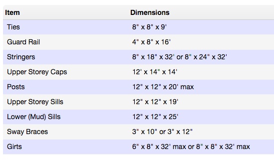

A word or two about size and proportion in relation to building the components of a trestle. Bear in mind that the size of timbers used in the construction process are huge and have to carry enormous loads and weight.
The main support posts for instance are 12" x 12" square and can weigh as much as 35 lbs. per foot of length.
When placed next to scale size people, freight cars and locomotives you start to realise how they will look when completed.
